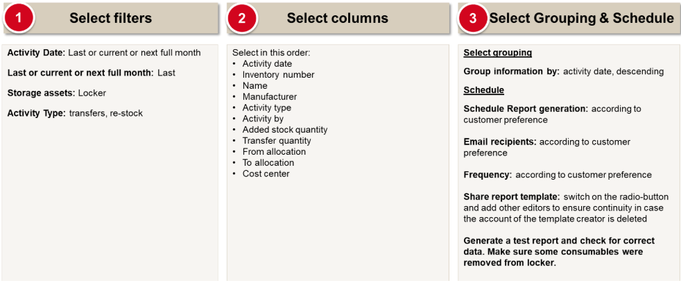

Steps to Create the Report

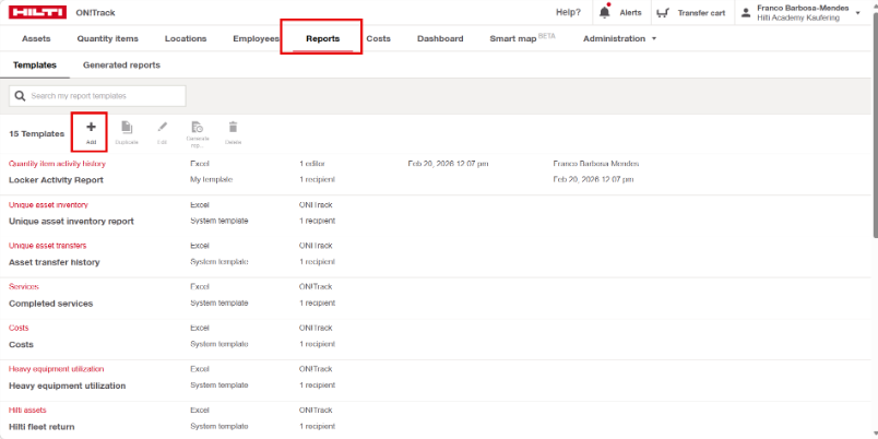

  • Go to Reports in ON!Track.
  • Click Add.

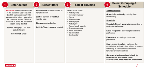

  • Select “Qty Item Activity History” as the report type.
  • Follow the four report setup steps and enter the required details.
Once completed, the report will be ready to view or use.
