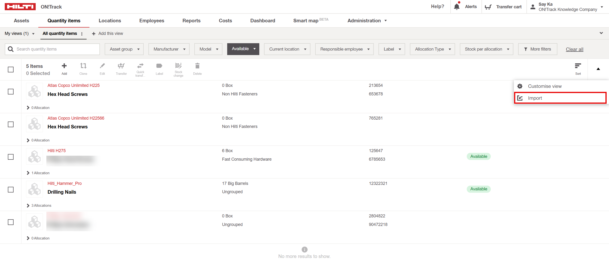

  • Go to the Quantity Items section.
  • Click on the drop-down action from the action bar and select the import icon.

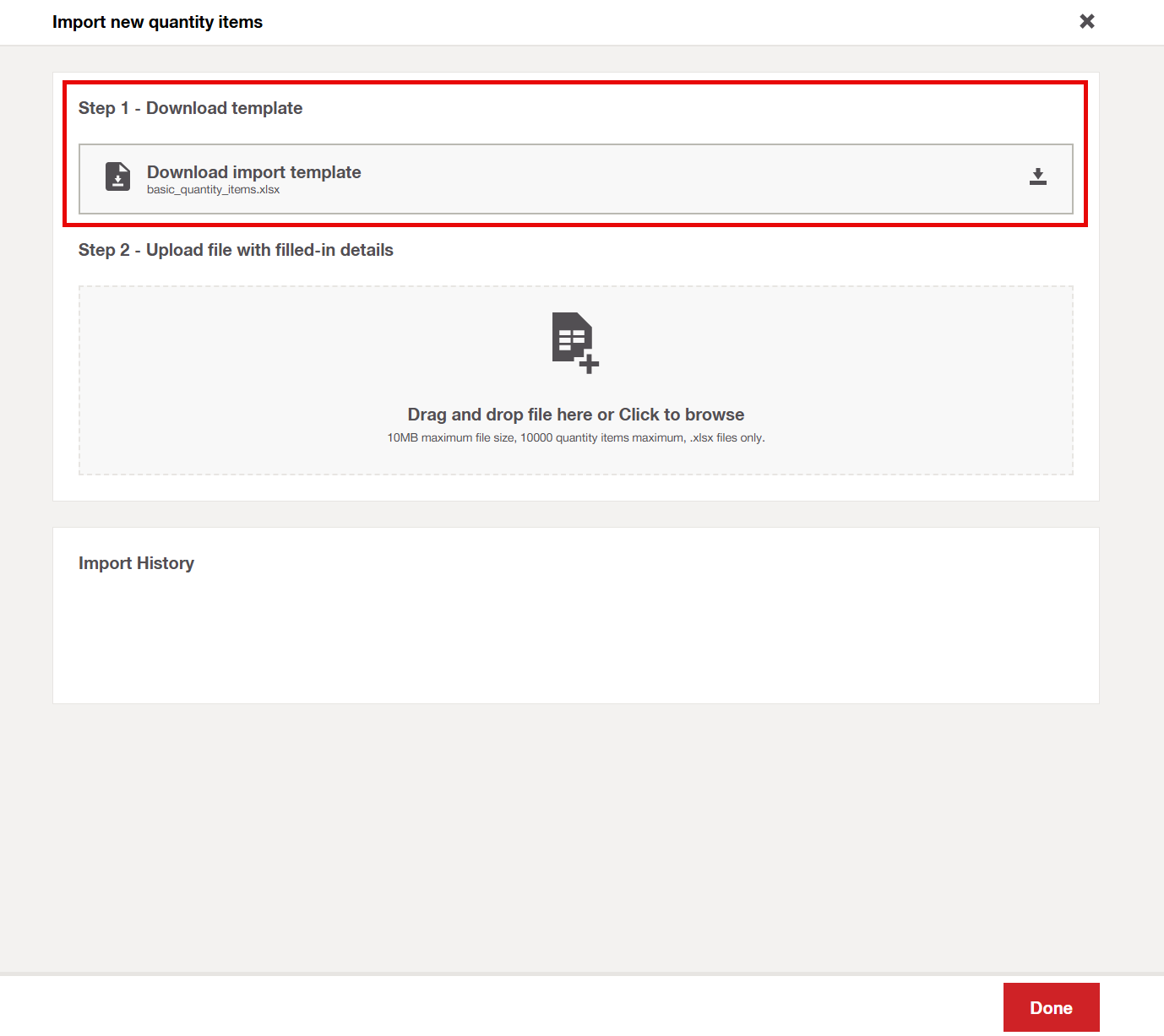

  • Upload a template with new allocation details.

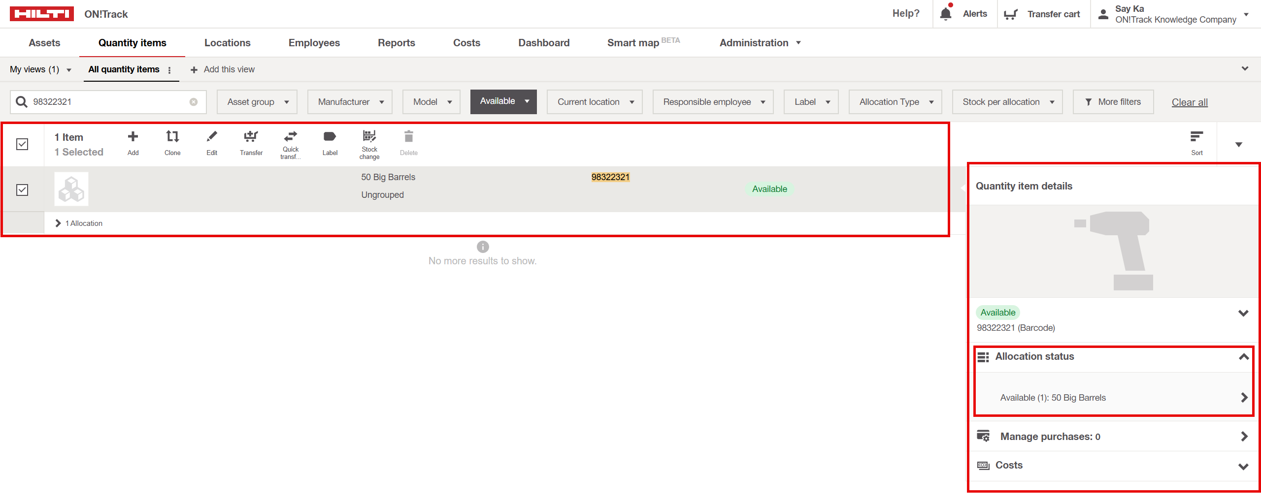

  • Verify the import history with the status "Completed" to ensure the allocations were imported successfully.
  • The newly imported allocation will be visible in quantity items list.
