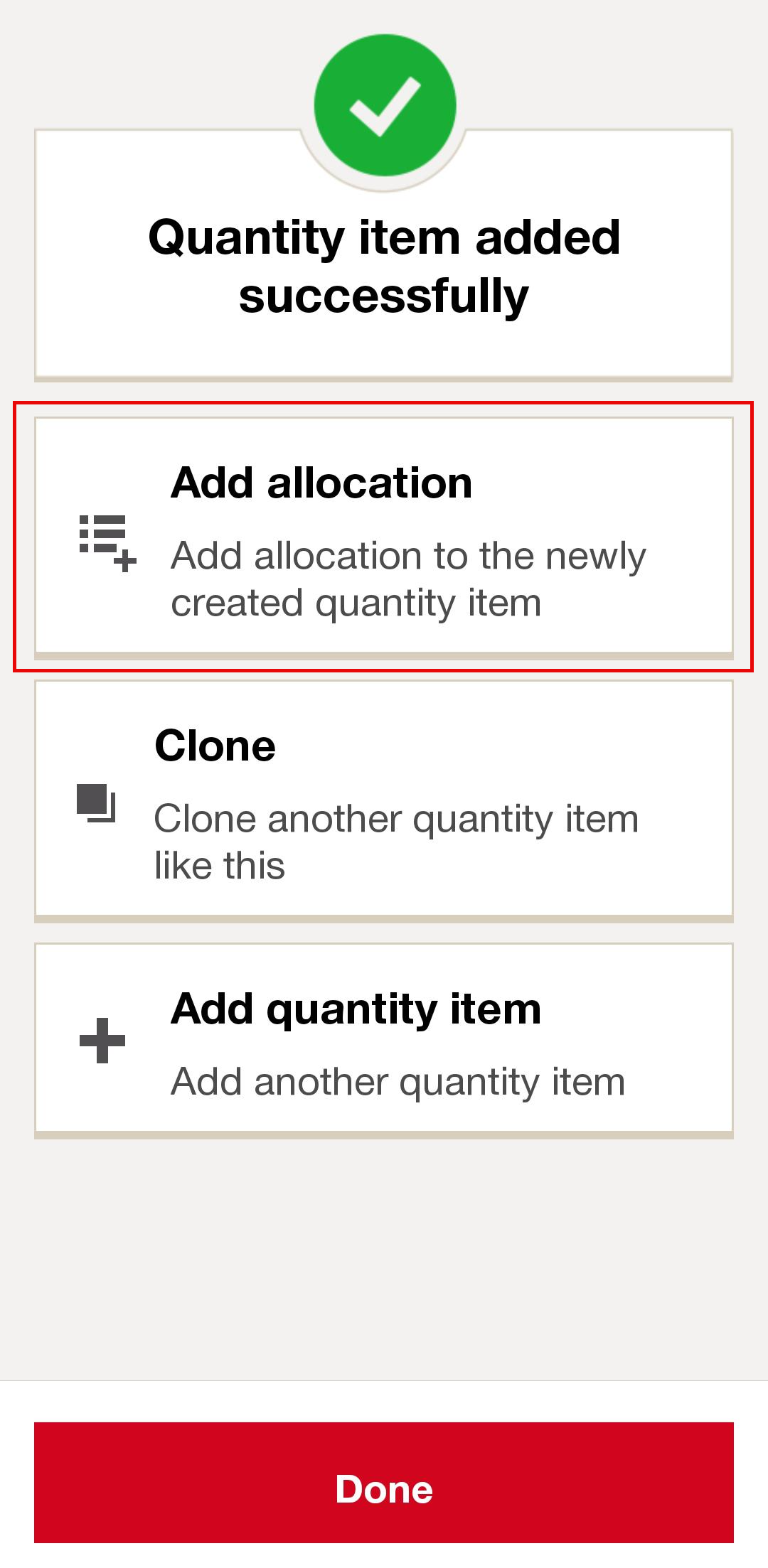

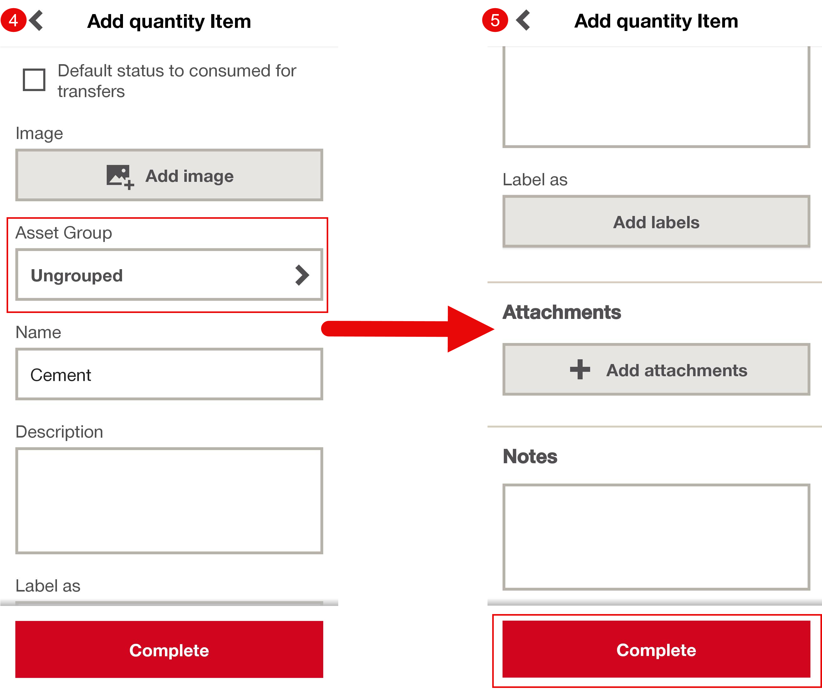

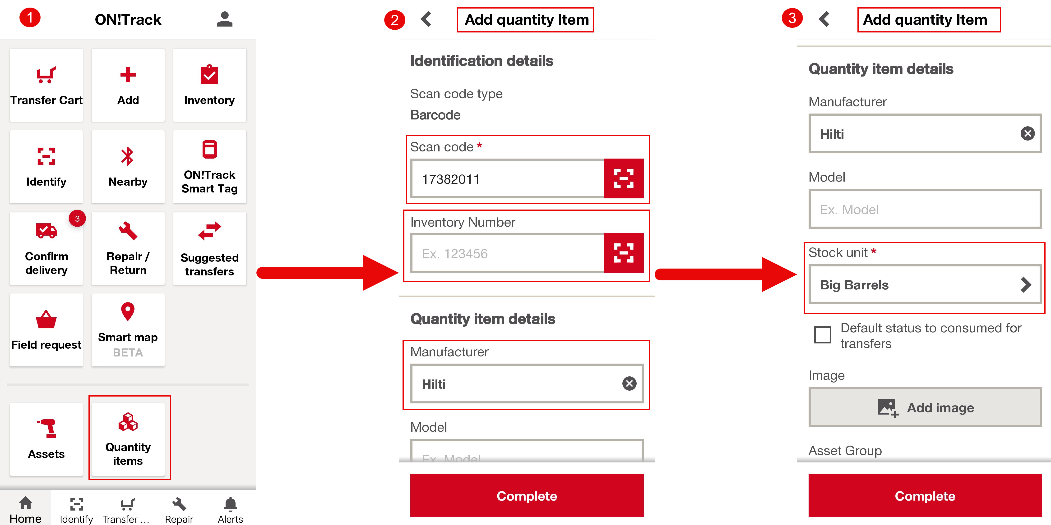

For Allocations of Quantity Items during Add Quantity Item workflow:
  • Click on adding a quantity item and fill in the required details.

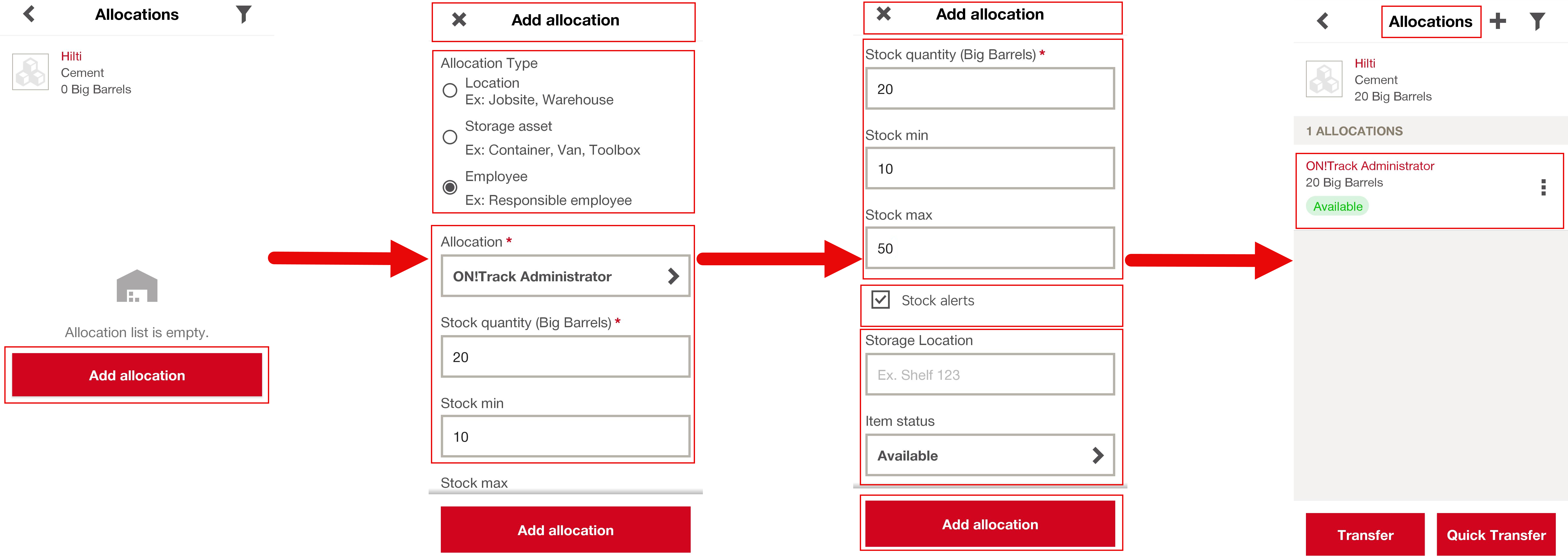

  • Click on the add allocation to add the allocation.
  • Click on the add allocation. Add all the required details and click on add and to get stock-related alerts, users need to turn on the ‘Stock alerts’ option.

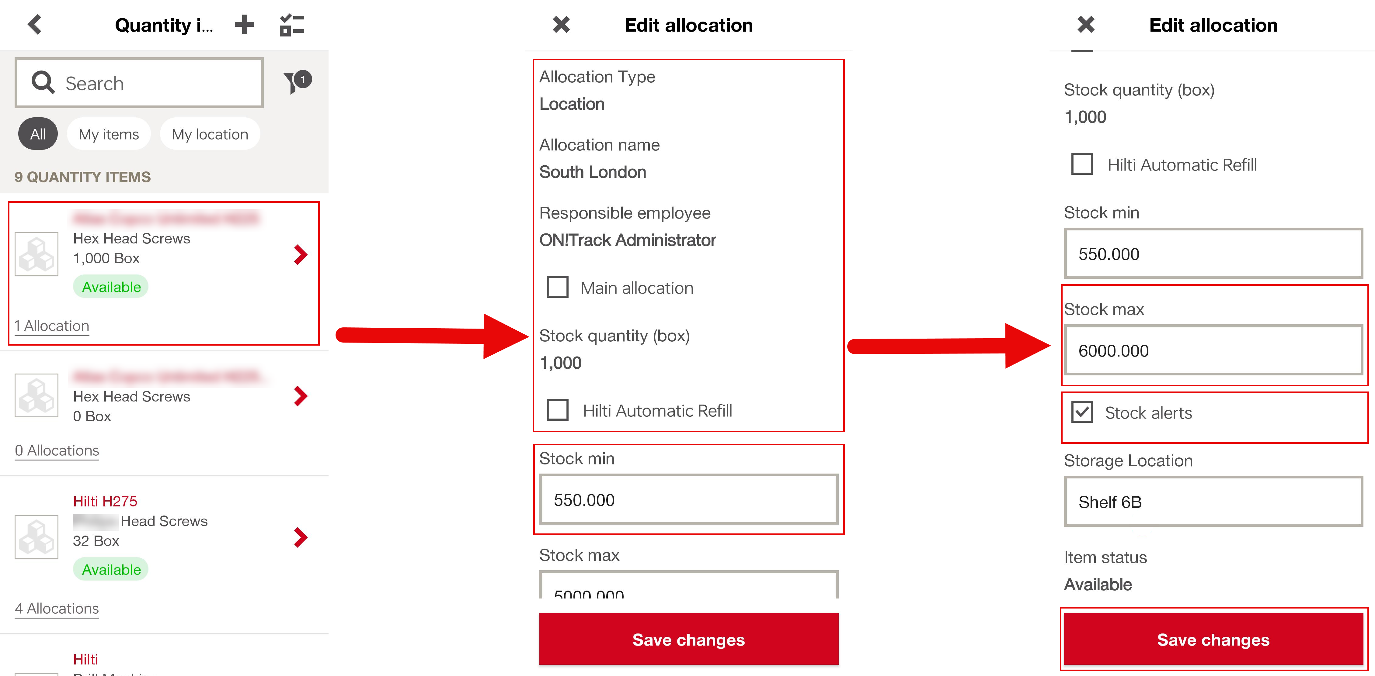

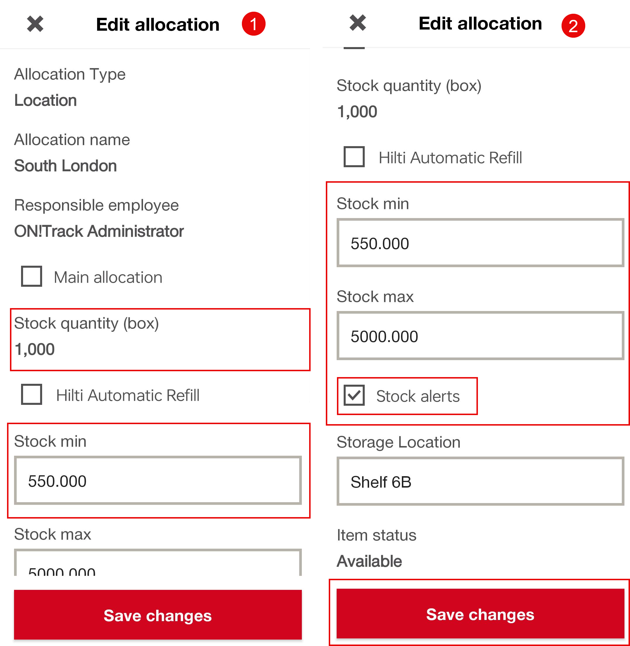

For Allocations of Quantity Items during Edit Quantity Item workflow
  • Click on the allocation of the required quantity item. Select the allocation and click on edit. Edit the required details and to get stock-related alerts, users need to turn on the ‘Stock alerts’ option.
