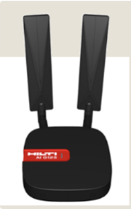

Stationary Gateway (AI G125)
The stationary gateway is installed at a fixed location such as a warehouse, jobsite, or storage area. It provides a permanent reference location for tracking asset presence. Once installed, it continuously scans for nearby tagged assets and sends the nearby asset information to ON!Track. It is not designed for get the Geolocation (GPS coordinates) and does not work in environments where bluetooth radio frequency is blocked/shielded.
 Core Capabilities
  • Typical scan coverage: Up to 30 m (clear line of sight). Reduced range in metal‑dense or high‑interference environments
  • Designed to handle up to ~300 smart tags per scan cycle reliably
  • Assignment options: Locations and Storage assets
  • Inventory checks to be performed against these locations, showing Expected, Found, Not Found and Unexpected.
  • If multiple gateways detect the same tag, no automatic transfer is shown
