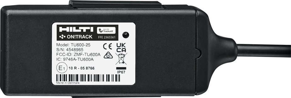

A Van Gateway is a device installed in a service van that automatically detects Bluetooth-tagged tools and equipment inside or near the van. It updates tool locations in ON!Track in real time — no manual scanning required. The gateway also records the van's last known GPS position, giving you location visibility for your mobile fleet.

Think of the Van Gateway as a Bluetooth listener inside the van. A Sensor or Active Tag sends a Bluetooth signal. and the Van Gateway listens for these signals and uploads detections automatically.
  1. Tools fitted with Bluetooth tags (e.g., Sensor Tags such as AI T320 or AI T380) are placed in the van.
  2. The Van Gateway continuously listens for Bluetooth signals from these tags.
  3. Detection data is uploaded to ON!Track via cellular connectivity (LTE-CAT M / NB-IoT / 2G).

  • Mount the gateway device in the van. The gateway connects via an OBD-II connector harness to the vehicle's power supply. Professional or Hilti-supported installation is recommended.
  • Register the Van Gateway in ON!Track and link it to the correct van or storage location.
