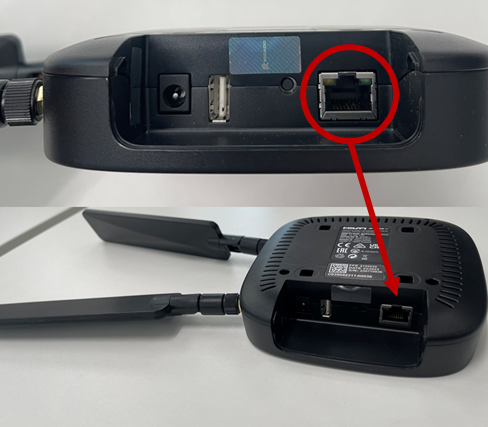

The Stationary Gateway AI G125 connects to Cloud via cellular connectivity OR cable (LAN). It is always recommended to make use of cellular connectivity, when possible.

  • LAN connection and implications
    • LAN and SIM card connectivity do not work simultaneously
    • LAN network will always have a priority over SIM card connectivity
    • Once a LAN network is connected SIM card connectivity will be disabled
    • If the LAN network breaks down, the SIM card does not act as a fall-back connectivity solution

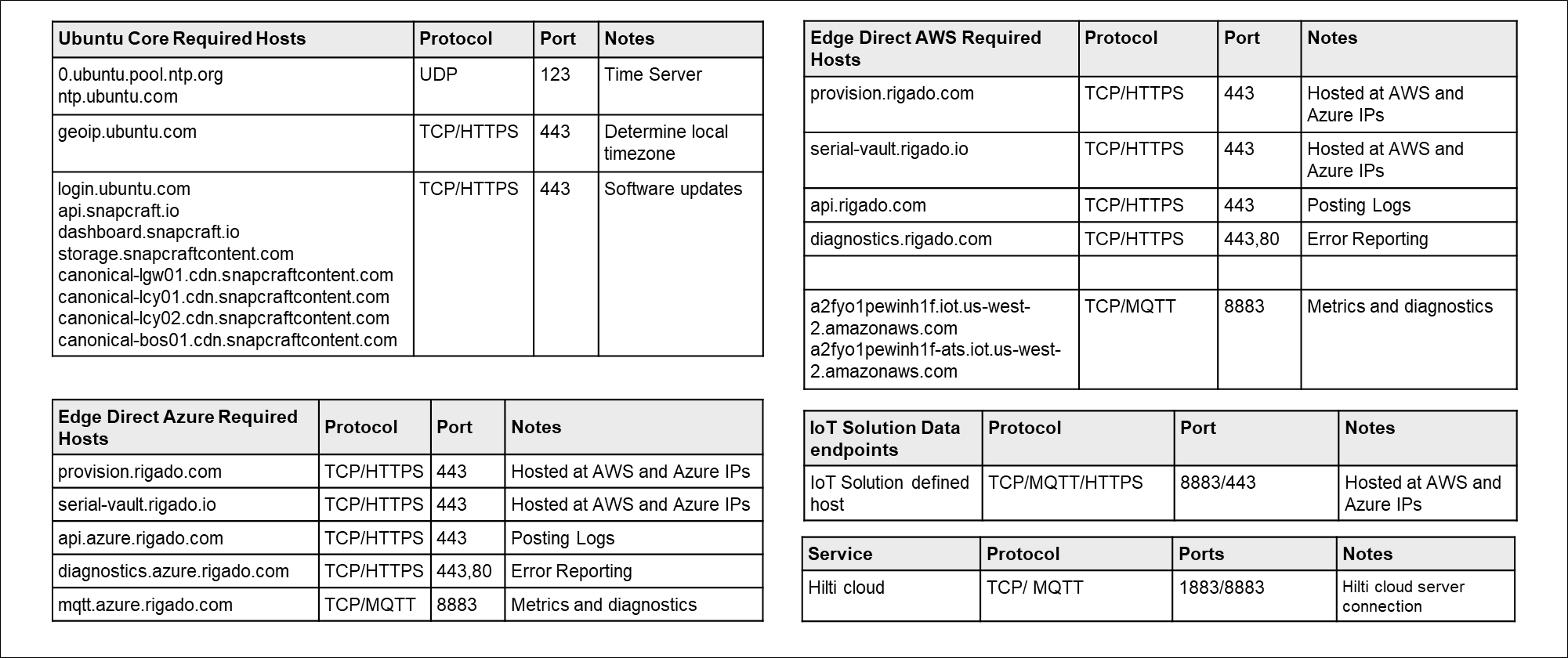

  • If your network is protected by a firewall: The following ports needs to be accessible by the gateway.

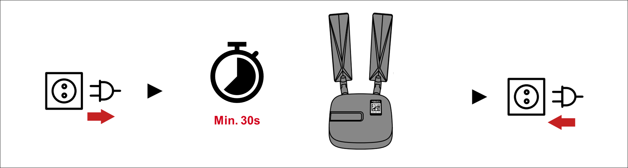

Gateway Rebooting
In case of issues with the Stationary Gateway AI G125, a reboot might be required by the Hilti Support Service. To reboot a gateway, simply unplug it from the power socket, wait min. 30s and plug it back.

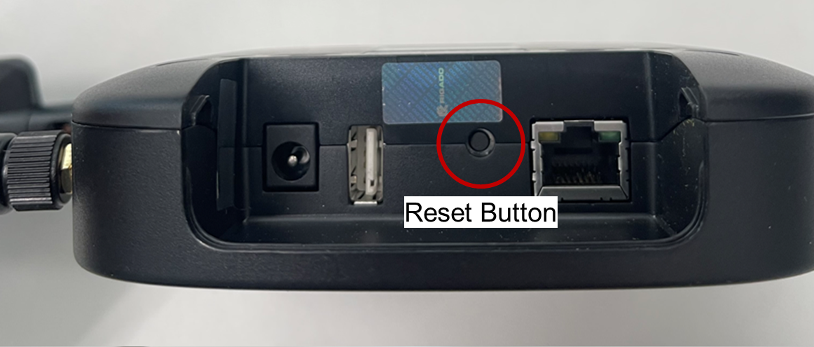

  • Never press the reset button
If the reset button gets pressed, it might cause permanent damage to the device.
