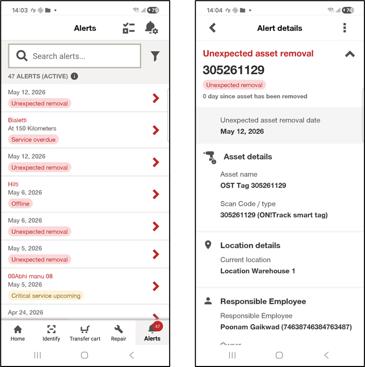

UAR Alerts
The UAR alerts appear in the Alerts section of ON!Track and can be distinctly identified with "Unexpected removal" label.

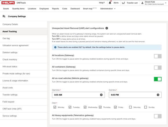

UAR alerts setup
Applicable for Admins and Support Admins. They configure this via Company Settings → Asset tracking, where the "Unexpected asset removal (UAR)" section appears. Settings can be configured for each day of the week including timings

No suppression window is active — If an admin has configured a UAR suppression time frame for that entity type (via Company Settings → Asset tracking), alerts will not be generated during the suppressed period, even if all other conditions are met.
