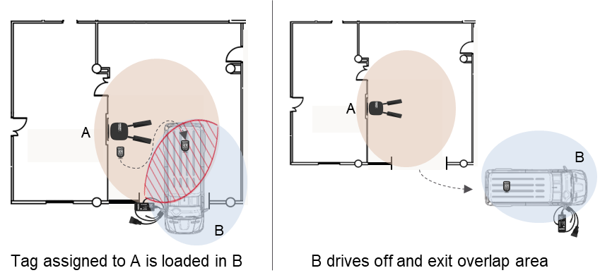

What Happens as a Tool Moves Between Gateways?
Below is how the system behaves when a tool moves from Gateway A to Gateway B.
With Automated Transfers ON
  1. The tool is assigned to Gateway A.
  2. The tool starts moving and enters Gateway B’s range.
  3. Gateway B detects the tool as Found, while Gateway A may show Unexpected (during overlap).
  4. After the delay, ON!Track automatically reassigns the tool to Gateway B.
With Suggested Transfers (Automated Transfers OFF)
  2. The tool enters Gateway B’s range.
  3. Gateway A stops detecting the tag and shows Not Found.
  4. Gateway B starts detecting it and shows Found and Unexpected.
  5. A suggested transfer alert appears and stays active until approved.
  6. The transfer only becomes official after someone approves it.
