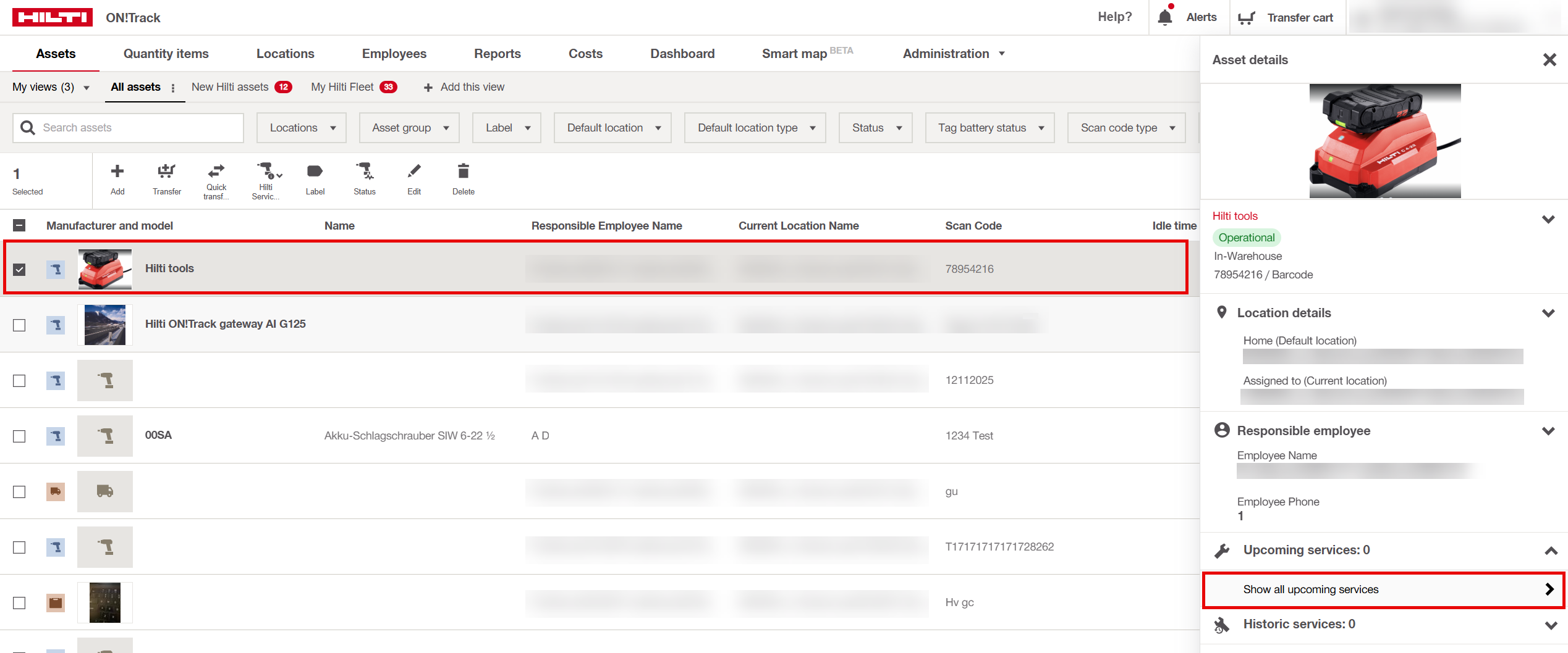

  • Log in to the ON!Track web portal and start adding a new asset, refer to these articles to create new asset:

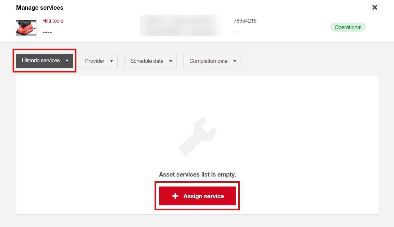

  • Once the asset is created and click on asset details and open the upcoming services.
  • Choose a historic service template from the dropdown and click on assign service.

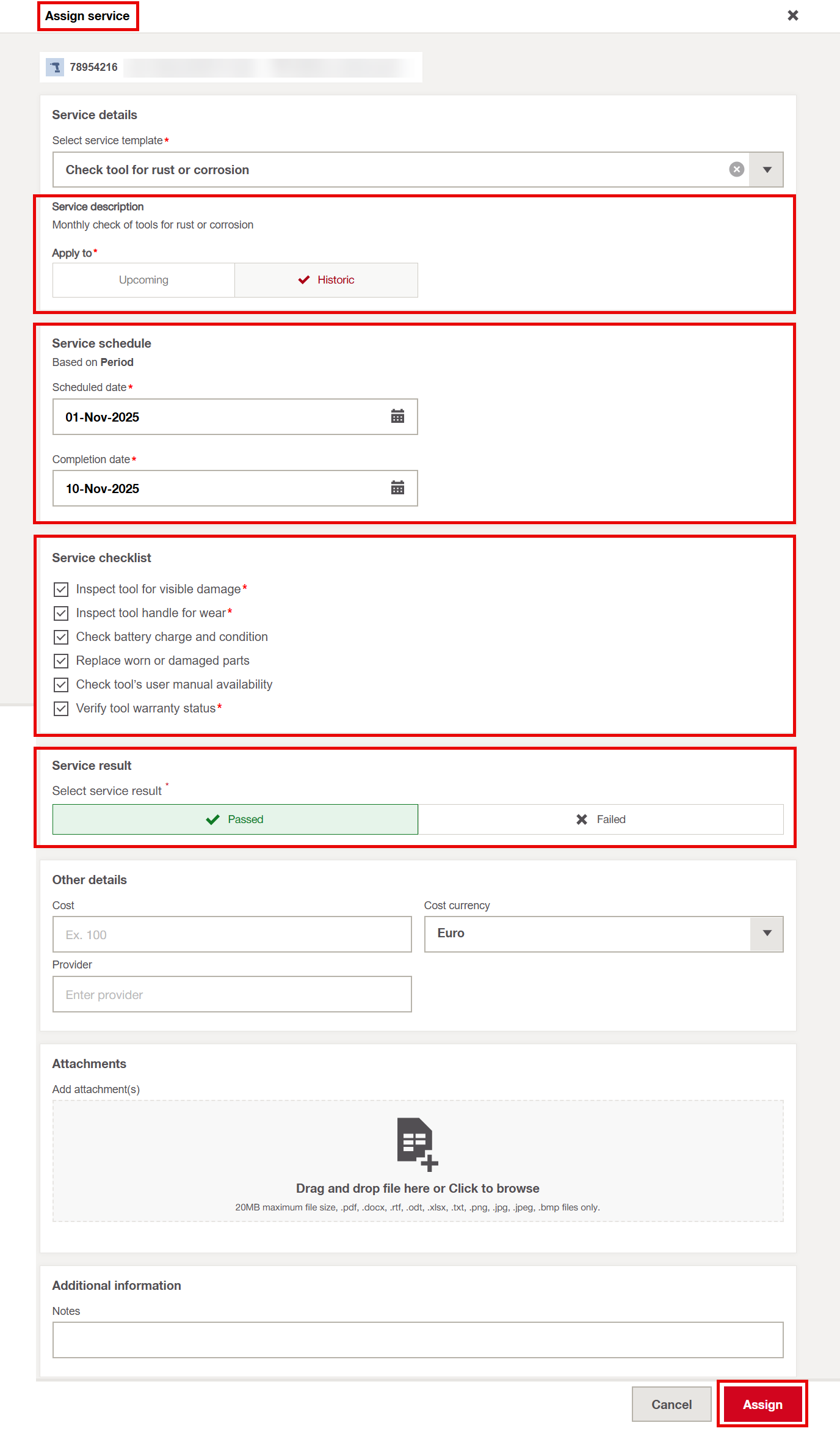

  • Enter the scheduled date, completion date, and select the service result (PASSED or FAILED)
  • Complete the checklist items
    • To mark the service as PASSED, all mandatory checklist items must be checked.
    • If any mandatory item is left unchecked, you’ll see a warning.
  • Click Assign to save the service.

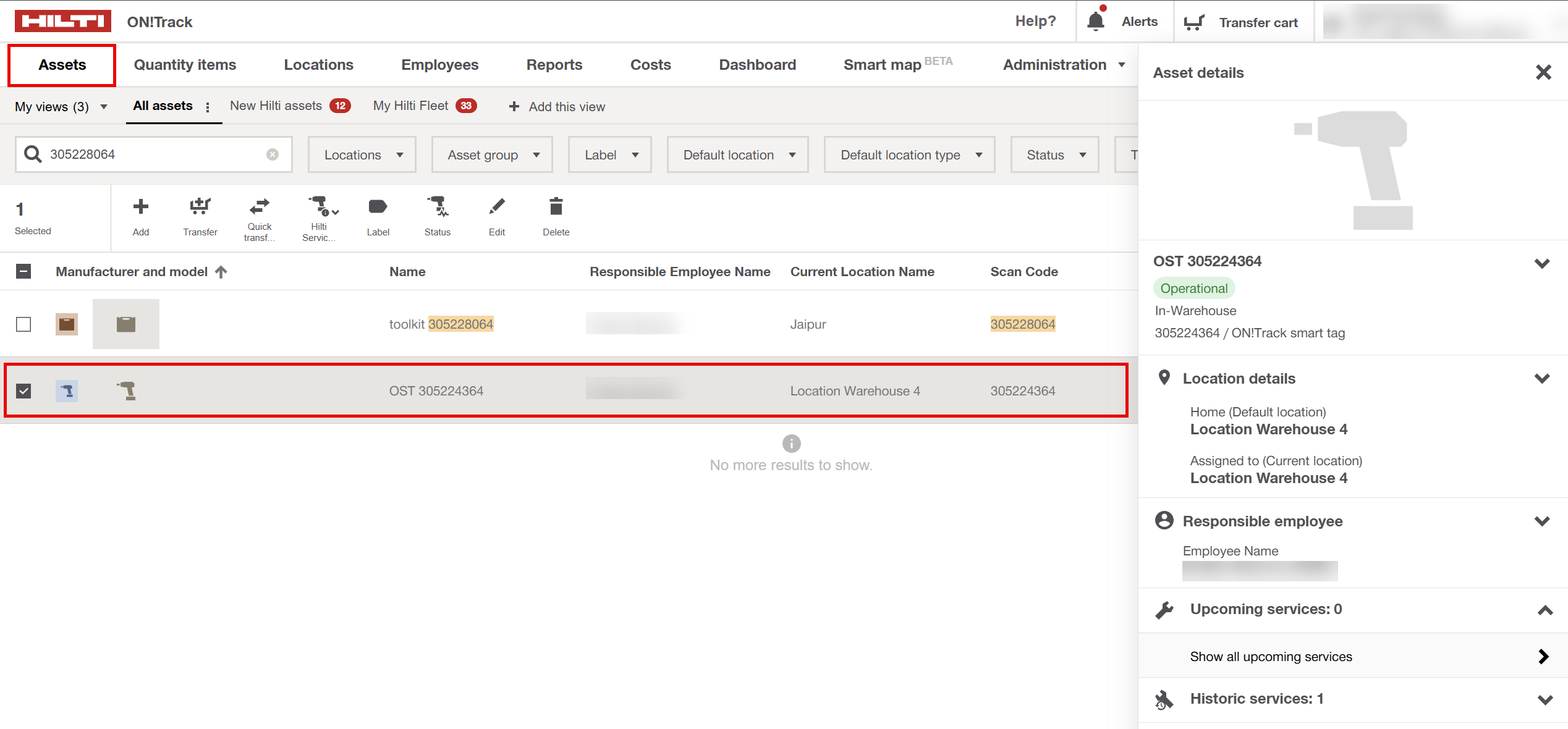

  • For Existing Assets:
    • Search for and select the asset.
    • Click to view all historic services.
    • Follow the same steps as above to assign a historic service and complete the checklist.

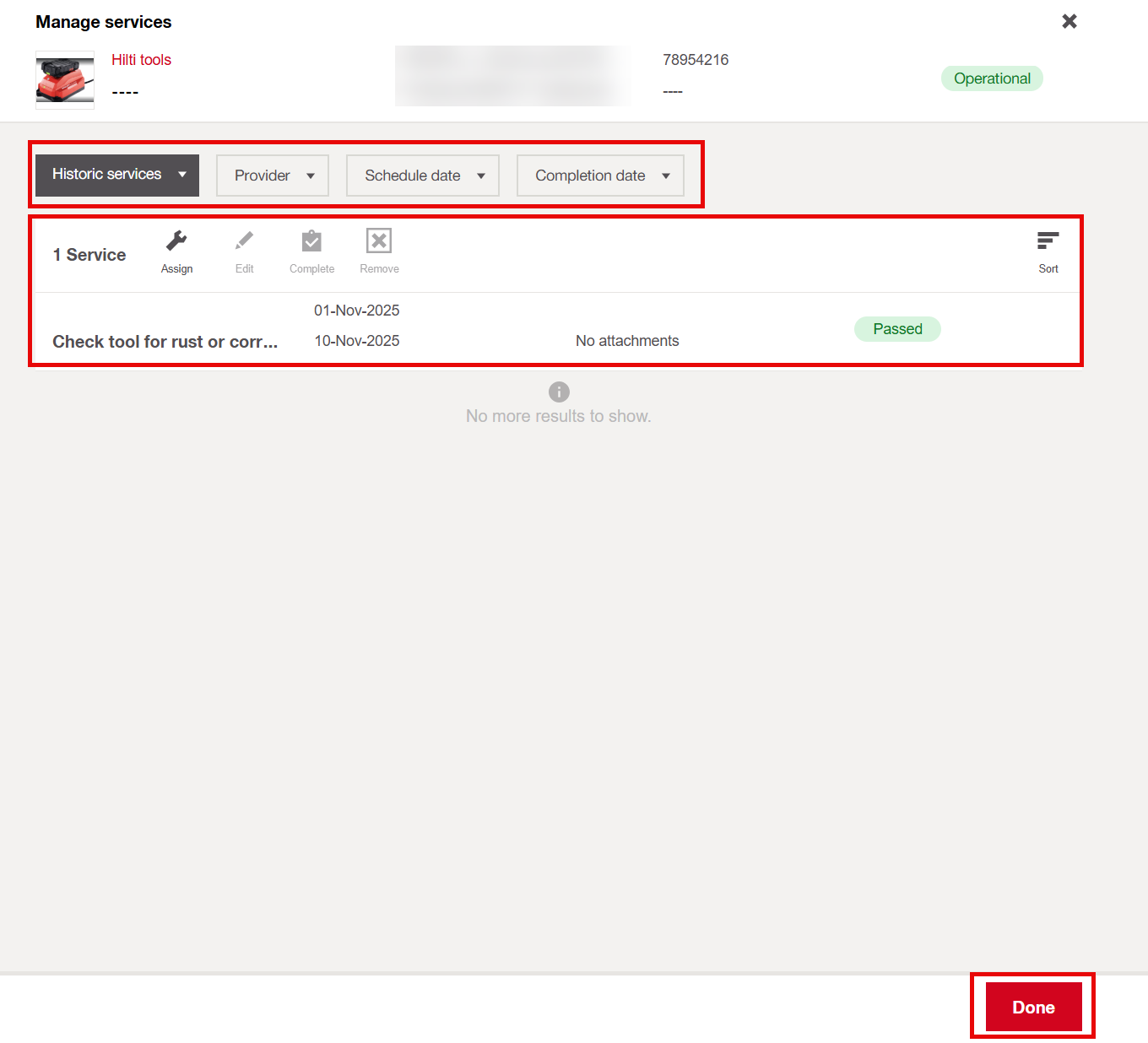

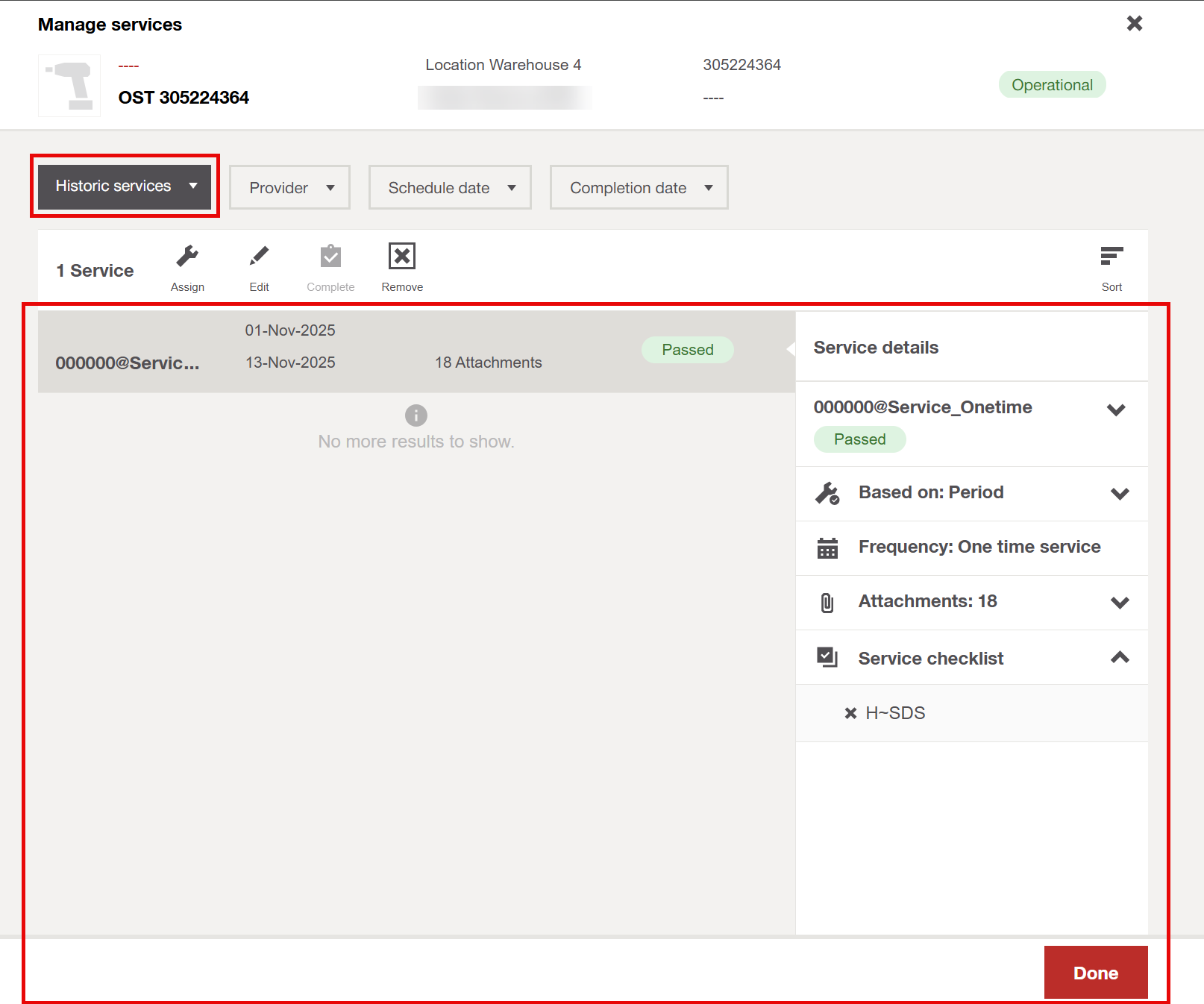

After Submission:
  • The historic service and checklist are saved with the asset.
  • You can view the service history from the asset’s detail page.
  • You can export the service history from Report section as a PDF or CSV file.
