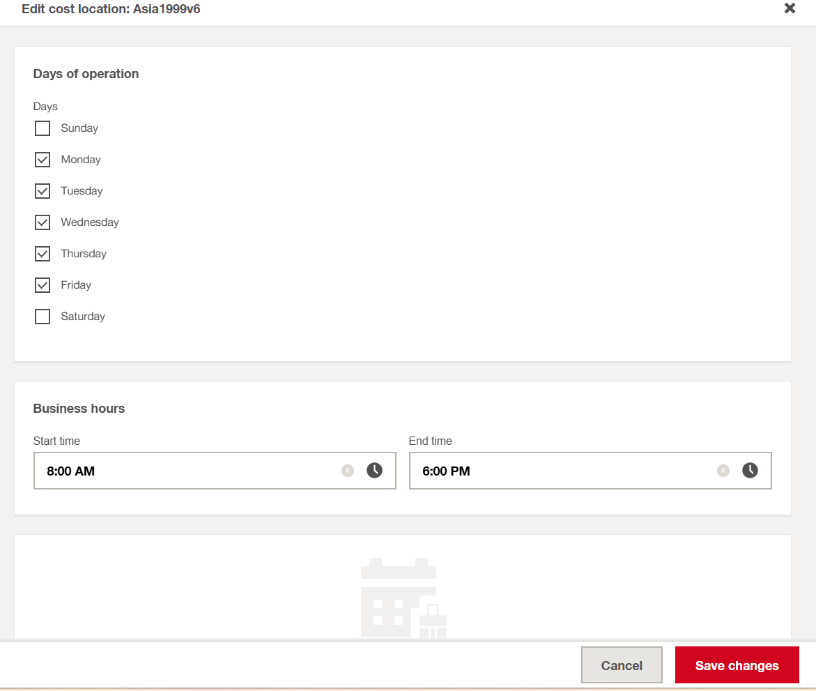

Administration → Cost Location Settings → Find your location → Edit the setting
Each jobsite has settings that allow the customer to define:
- Working days (for example, Monday to Friday)
- Working hours
- Public holidays or other non-working days
