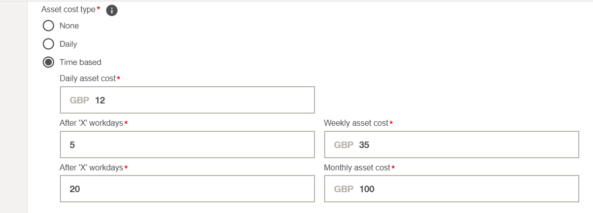

Example:
Example Configuration
  • Monthly Rate = $100
  • Included Monthly Days = 20 days
  • Weekly Rate = $35
  • Included Weekly Days = 5 days
  • Daily Rate in Time based charges= $12
  • Asset Movement
    • Asset transferred into the jobsite: 1 January
    • Asset transferred out of the jobsite: 17 March
    Note- No Cost location setting, All days are considered as working days
    Assume the asset exceeds the configured monthly threshold of 20 days in both January and February.
    January
    The asset remains on site for more than 20 chargeable days.
    Charge = Monthly Rate = $100
    February
    The asset again remains on site for more than 20 chargeable days.
    March
    The asset remains on site until 17 March. Assume that only 2 chargeable days remain after applying the monthly and weekly rate rules.
    Since these remaining days do not qualify for another weekly or monthly charge, ON!Track applies the configured daily rate.
    March Charge = 2 days × $12 = $24
    Total Cost Calculation
    PeriodApplied RateCost
    JanuaryMonthly Rate$100
    FebruaryMonthly Rate$100
    March (remaining 2 days)Daily Rate$24
    Total Asset Cost = $224
