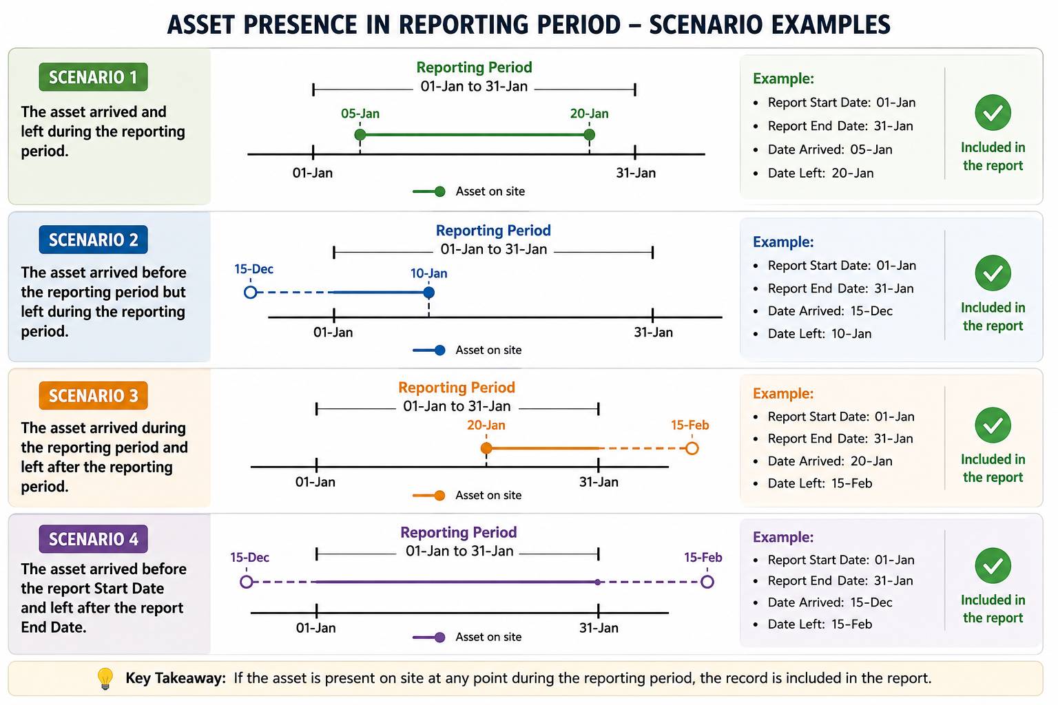

Scenario 1
The asset arrived and left during the reporting period.
Example:
  • Report Start Date: 01-Jan
  • Report End Date: 31-Jan
  • Date Arrived: 05-Jan
  • Date Left: 20-Jan
Since both dates fall within the reporting period, the record is included in the report.
Scenario 2
The asset arrived before the reporting period but left during the reporting period.
Example:
  • Date Arrived: 15-Dec
  • Date Left: 10-Jan
Since the asset was still on site during the reporting period, the record is included.
Scenario 3
The asset arrived during the reporting period and left after the reporting period.
Example:
  • Date Arrived: 20-Jan
  • Date Left: 15-Feb
Since the asset was present during the reporting period, the record is included.
Scenario 4
The asset arrived before the report Start Date and left after the report End Date.
Example:
  • Date Left: 15-Feb
Since the asset remained on site throughout the reporting period, the record is included.
