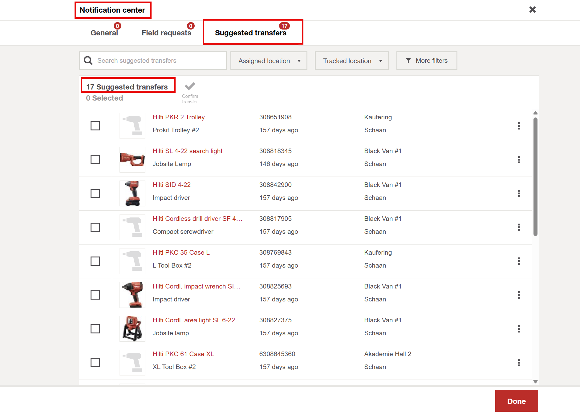

The suggested transfers can be viewed in a new tab under the alerts section called "Suggested Transfers."
What the suggested transfer list shows
  • The list includes assets assigned to one location but detected by a different gateway-enabled location or storage asset.
  • These require manual review and action from the user to either transfer the asset or investigate why it’s misplaced.
  • New tags appear in Suggested Transfer about 10 minutes after entering the gateway range.
